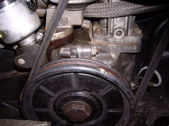

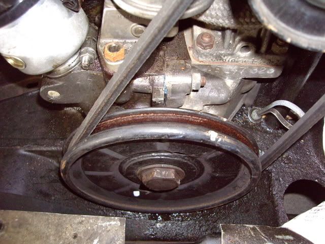

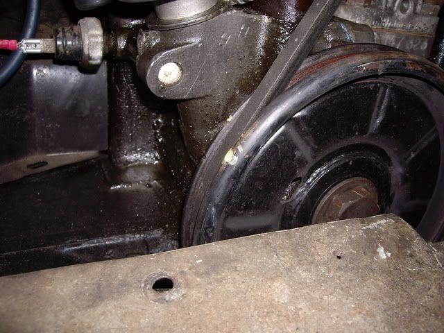

it took 20 minutes in the dark but i have a few pictures. make what you can out of them. looks like 3 marks, plus a random paint mark on the face of the pully. two notches, and a dimple are the 3 marks
thanks for your help[/img]

Hey !  You did good.  These are all factory marks. From left to right in the pics ,the left notch is  5 degrees retarded.  The "dimple" on the outer edge of the pulley is 0 degrees (white smudge). The right notch is 5 degrees advanced.  Forget about the notch to the left. This notch was used to set the timing when the dist. had a double pull vacumn unit (early emission days. '68-'69)   Some people set the timing at a ldle on the 5 degree advance notch(extreme right) but they didn't have a clue to what the total advance ended up being if they had a dist. that was a little spasic (most of them).
        This is what I do. Take a 3 cornered file and file a notch straight across the dimple to the inner rim. This will give you a absolute "0" mark.Paint it red or something so you can find it when the engine is running at a idle.  If you have a timing light with a advance knob, set the knob on 32 degrees, rev the engine to about 1800-2000 RPM and move your dist, until your NEW "0" mark lines up with the split in the case. Lock her down and you are done.
         If you have a timing light that doesn't have a advance knob, you can do the Poor Man's trick. From the middle of the NEW notch you filed, take a tape measure and measure EXACTLY 2" to the right (clockwise)on the back rim and make a mark. You will be real close to 32 degrees. Rev the engine and move the dist. to that mark.
         With all that said and done, if the marks don't move at all, you more than likely have a locked up dist. Fix or replace it.
