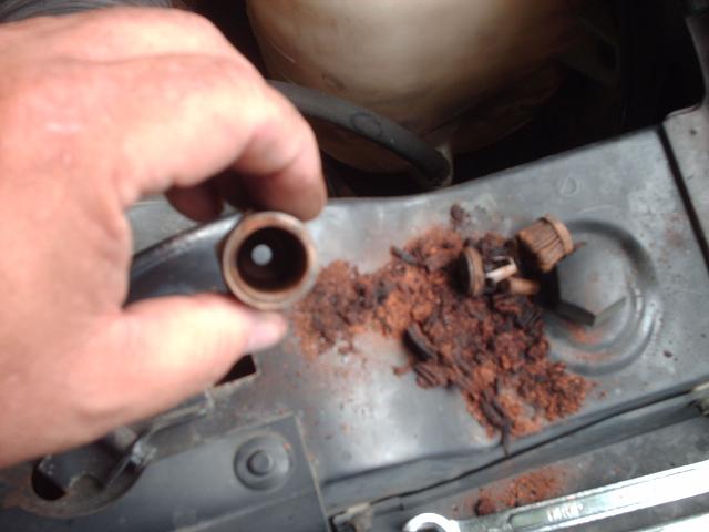

I doesn't really matter what kind of vehicle it is, if it's over 20 years old, has over 150,000 miles on it and has been sitting for several years, you "might" want to change the fuel filter.  My '84 S-10 died on me on the way home from work Thursday.  After I got home (on a roll-back), I finally got the fittings broke loose and got the filter out of the carb.  The fitting looked like someone had packed rust powder in it and pressed it in under a few thousand pounds pressure.  Now I know why it quit running on the way home from work, but I'm still trying to figure out why it didn't quit running a long time ago.   :oops:

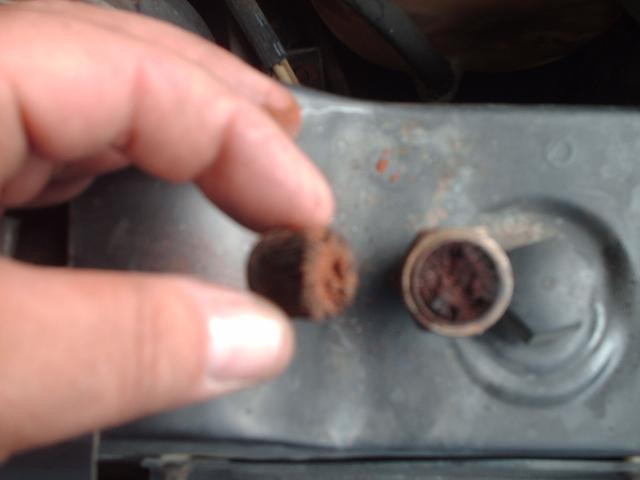

Here's what my filter looked like.  This is supposed to be a paper cartridge inside the housing thas screws into the carb.  It's a little longer than the housing . . . the part that stuck out the end broke off when I tried to pull it out, the other part I had to dig out of the housing with a screwdriver.

Can you immagine what is still in the tank? :puke:
I might want to go with a LARGER fuel filter this time, replace that little one as a secondary...
Just my $0.02 worth.

Quote from: "ASBug"
Zen,
 . . . and now that I've cleared the blockage, there's no telling what's going to make it to the carb.  I didn't have to worry before . . . the rust was packed so tight, the gas couldn't even get through!   :lol:
