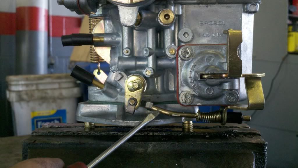

Maybe the adapter to carb gasket then. You will still need to pull the carb to see, it really shouldn't be possible for the accelerator pump to leak vacuum,only gas.  The pump should be full of gas, and in most cases there is a check valve if some sort to prevent venturi vacuum from pulling extra fuel under any condition other than accel.  Any leak should be a gas leak. there are a couple spots that can be bad vacuum leaks, since you already mentioned testing the base plate to intake, the next would be the adapter to carb, throttle shaft at carb, any of the removable plugs on the side or even a split vacuum port cap.

http://i162.photobucket.com/albums/t280/rxv8rx7/2011-09-28_14-14-31_593.jpg
If this is the right pic, you can see above the screwdriver the adapte gasket I'm talking about.

Some goon put 2 gaskets in the sp to dp adaptor area.
One was toast.
Flat spot was plastic nut on back was gone (melted....)
