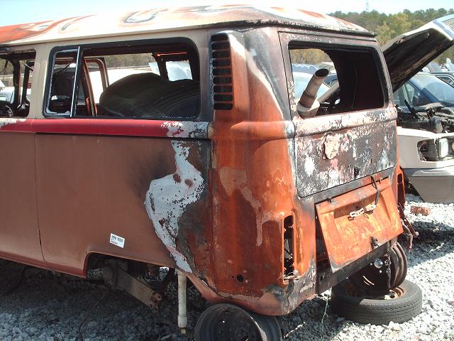

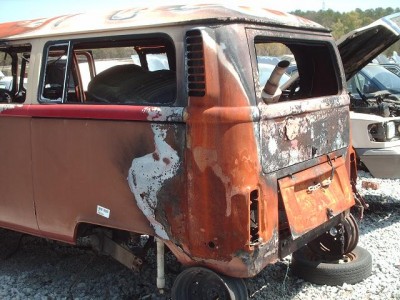

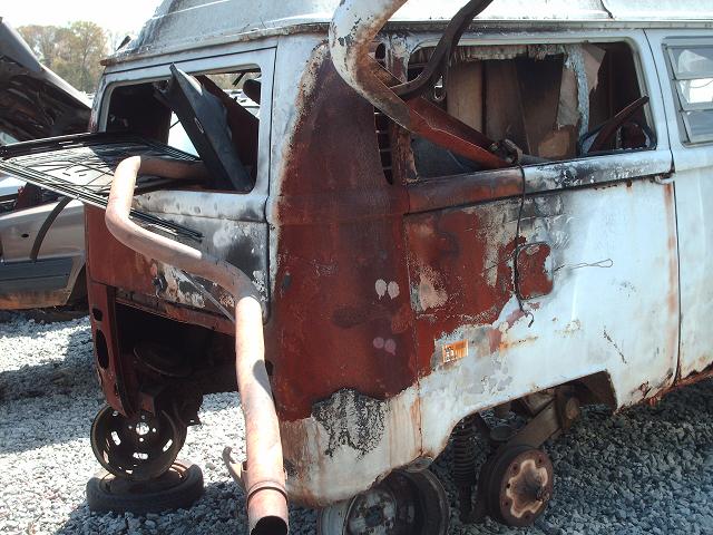

I have seen more than one electrical fire start up in a beetle / ghia due to a light switch popping apart, the hot lead grounding, etc, etc.....
At least with a bus, the fuel tank isn't located right there.... :shock:

Under the bed= too far away, keep it closer... :D
Electrical Help!!!
« Reply #10 on: April 08, 2009, 05:12:26 PM »
Having a big extigushier is good, but like Rick said, if it's under the bed, it's too far away.  If it catches fire, the bus will be burnt to a crisp by the time you get the extingusher out.  You need one you can reach from the driver's seat . . . and maybe a second one you can get to by opening the rear hatch.  Getting the fire put out quickly is the only way to save it.
