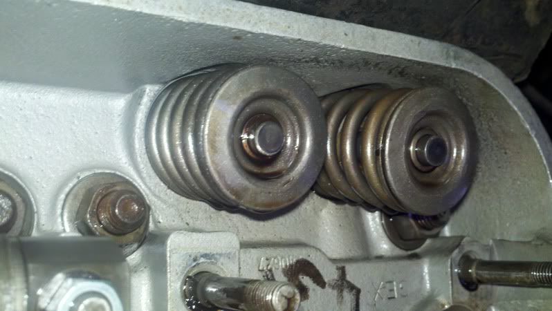

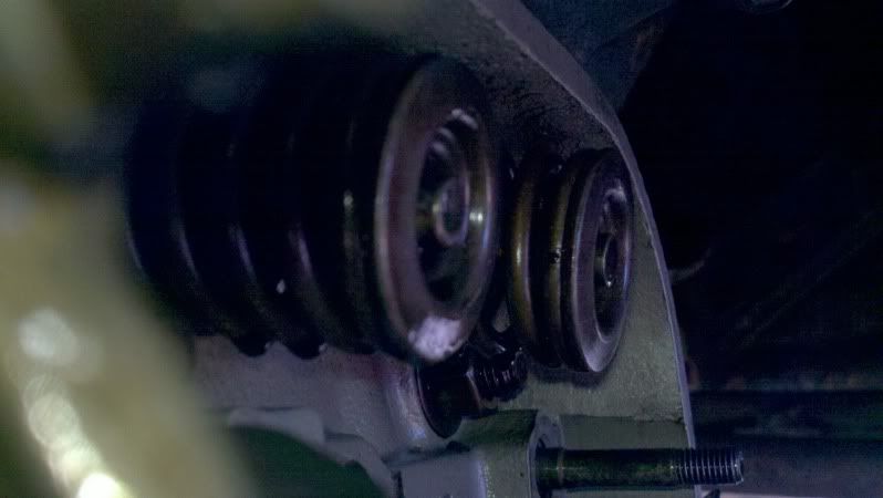

so I popped off my valve cover today on cylinders 1&2 of the 74 bus since it has been idling lately with a miss.... I figured I would find a valve needing to be tightened.... instead what I found was a rocker arm over an intake valve that had so much play in it I could literally stick my finger between it and the valve. and the adjuster was still tight!
Not sure if you can tell from the pics, but the valve is actually stuck about a half an inch in the head. the spring is still compressed, but the valve isnt coming all the way back out. what would cause this? dropped valve guide?

Dropped valve seat.  The valve seat is a hard steel ring that is pressed into the head,when conditions are right..ie heat,age,quality of original fitment..the seat will fall out of the head when the valve opens and then when the valve closes it won't go back all the way.  It won't come off the valve unless it breaks or the valve breaks, it just pounds the life out of the head everytime the valve is opened and closes.  The valve spring pressure is probably between 200-300 psi which makes for a pretty good hammer.  Type 4 engines and 140hp Corvair engines are known for dropped valve seats.  That's my guess.
A intake seat falling out is pretty rare. I have seen my share of exhaust valve seats falling out. No matter because the head has to come off. You might get lucky and find a nut or screw behind the head of the valve. I have seen that before. Seeing how you have one those rebuilt engines from" $^#%&@$%*^#$"  there is no telling what you are going to find. Keep us posted.  Your name will be posted on the Type- 4 "Wailing Wall of Shame"
