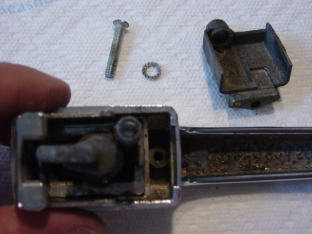

Here is a step by step on how to re-key your doors to use the key you have.  I would guess I'm not the only one that has no door key and money!! :(  Anyway, the whole process only took about a hour.

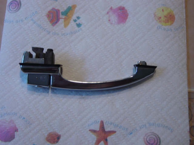

all you have to do to remove the handle is take out the 2 screws in the door right above the latch.  Then PUSH the handle forward about a 1/4 in. it should pull straight out now.
This is the handle on the inside
remove the single flat tip screw and remove the housing

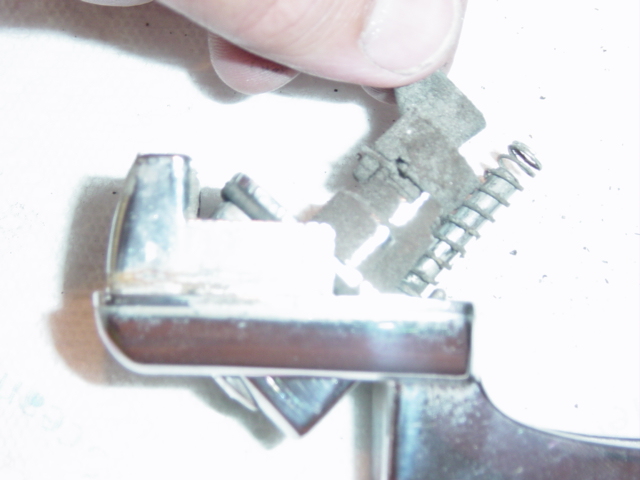

More

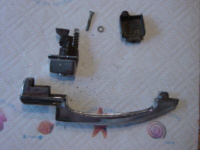

Tilt the button to the inside and slid it out.
Here it is apart

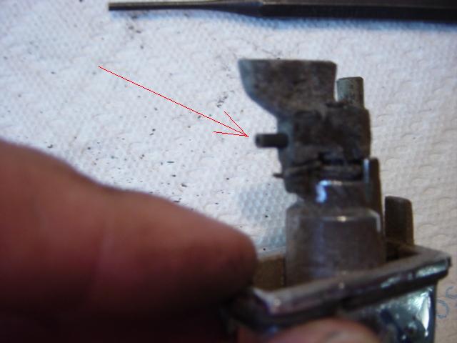

Here is the roll pin that needs to be pushed out.
Offline attack chicken
  • Ooltewah
  • Joined: May 2007
  • Posts: 421
Cheap(free) re-key for early door handles!
« Reply #2 on: June 25, 2007, 07:52:28 PM »

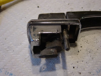

more
You don't need to push the roll pin all the way out!

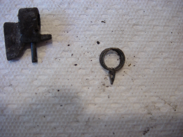

Here is the lock lever off.
Here is the spring and lock lever

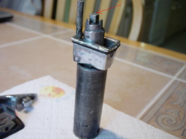

more

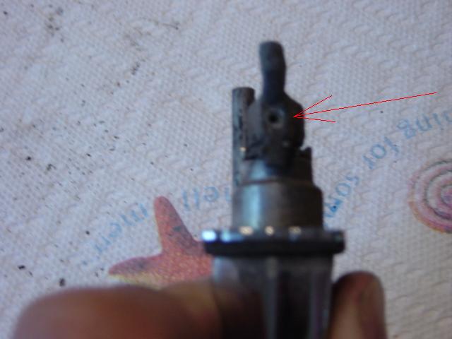

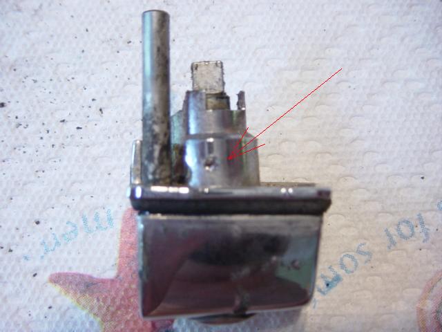

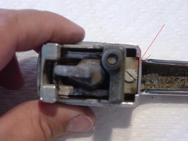

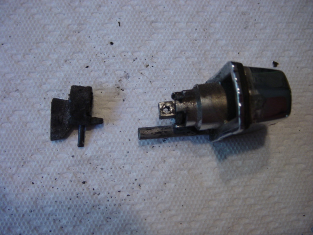

Here is a set/lock screw that probably will not move.
Knock on the lock cyl with a hammer.  It will break the lock screw but that doesn't matter the lock lever and pin will hold everything together.
Here is the lock cyl. knocked through

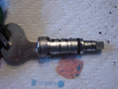

more

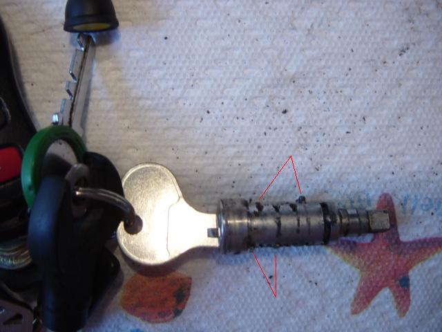

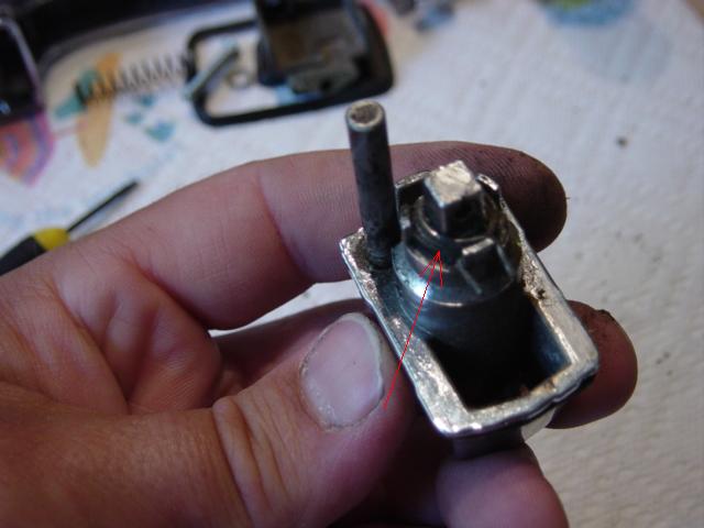

Here is the cyl. out of the button, you can see the tumblers and what broke off of the set screw.

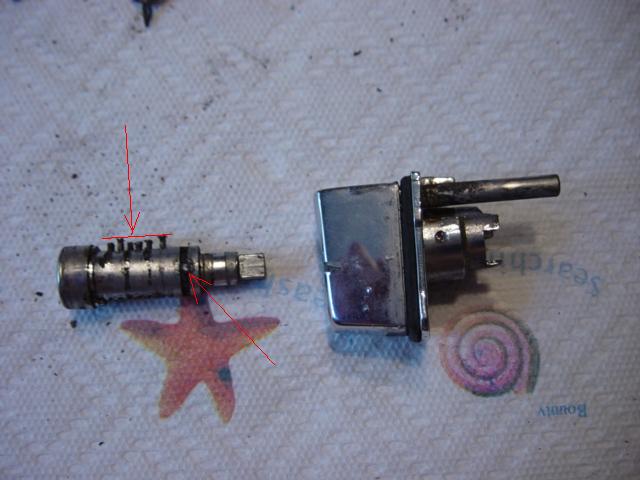

Here is the tumblers with my key in the lock.  All you have to do is grind them flat to the cyl with your key inserted and all is good, you can also just take them out but then any key will work. The key holds the tumblers & springs in the cyl. when apart
Here is the tumblers cut down to match my key.  When the key is removed the tumblers will stick up and prevent the cyl. from turning.

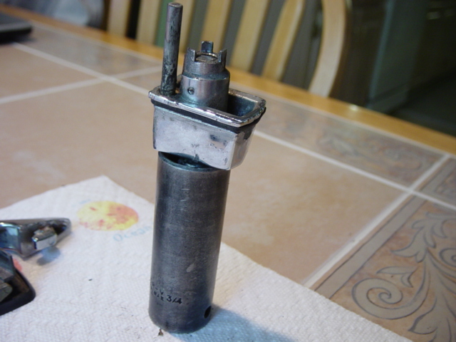

end

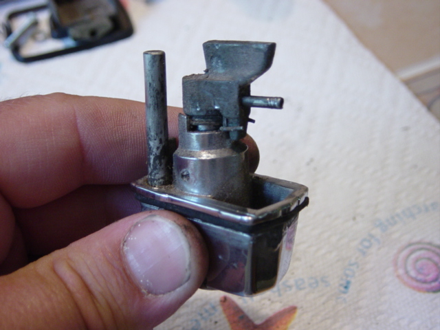

Here is a view of the return spring re-installed, this is what recenters the lock cyl after being turned.
Here is the lock lever and pin going back on.  This should be all that is needed to keep the cyl in place.
here is the button and cyl back in the handle... just throw the coil spring, housing and screw back on and re-install in the door and your all set!!

You can move tumblers around before you grind 'em off.  One of the lock cyl. I have was almost already set for my key, really only had to cut down one tumbler...all it takes to keep it from turning! :D

If you can, gather up several old broken door handles before you start.  Take 'em apart and separate the pins into sizes . . . sliding them onto an un-cut key blank makes separating them into different sizes easier.  Depending on the particular lock you are working on their will be either 3 or 4 sizes of pins.  From there it’s pretty easy to re-key the lock to fit an existing key without having to file any pins down.  And David is right about that being a hard one!  The later "trigger" style handles are MUCH easier to take apart.  One easy-to-remove screw holds the cylinder in place.
A neat trick is to fill the cylinder up with the pins that go where the key isn't cut . . . a key blank will work it, but any key with any notches in it will not work.
Now I'm going to climb up on my "certified locksmith" soapbox and ask one thing of anyone doing this . . . please file or grind off the old code number if you re-key a lock.  It might save a hard to find key blank or twelve sometime down the road if a future owner takes it to locksmith shop to have a key cut to code.  :wink:
