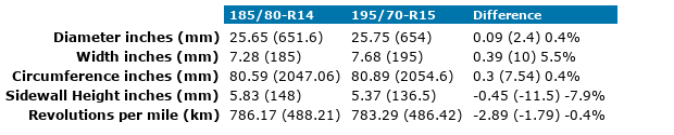

Ok, so if no Aspect Ratio (middle number) is used, then you assume an aspect ratio of 80(% of the width-the first number). So your 185R14C should be searched as a 185/80/14. I then searched for a tire calculator. The Miata Tire Calculator has always been my favorite, but doesn't work on a mac. I used http://www.tacomaworld.com/forum/tirecalc.php
Right now, Performance Plus has the Hankook RA08 on sale for $69 each through Feb 28, but only in the 195/70R15 size. How would that compare to the stock size of 185R14? They would be slightly fatter wouldn't they?
There would also be a .5" gap all the way around your rim! Their overall diameter would be .09" off (with the 195 being slightly larger in diameter).

Yeah I was excited by the price and neglected to notice it's a 15" tire. According to Karl in the tire sticky the assumed aspect ratio of 185R14 is 82.
I'm gonna stick with the 185R14 Hankooks I think.
