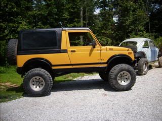

This is the only pic I have at the time. This was back in July of 08 when the other projects started. I had just got thru building and stretching the sammy in the pic and caught the ba-ha in the background. I have since put new 35s on the sammy and will use the old tires off it on the ba-ha or rat, whichever it becomes. Thinking of calling it a Reversed Ba-Ha Rat if I can pull of whats in my head.

oOOOooo I do like samurais.... they do well off road
