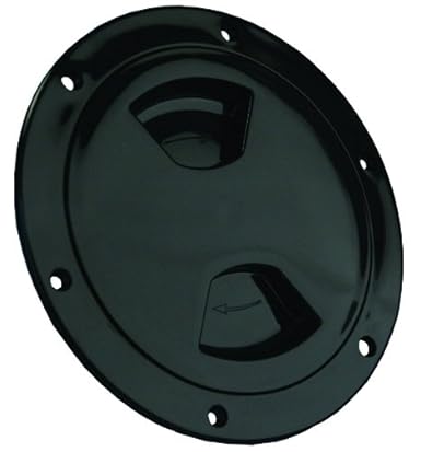

and i dont mind cutting a hole in the top.  i think i saw somewhere it was done and some kind of boat cover placed over the hole..... ???
Deck Plate Access Hatch or whatever. They have them at Academy Sports for relatively cheap. It sits flat and screws open with a large 4, 5 or 6" hole. They can also be water tight. The only problem could be the corrugated floor won't be flat to fasten it down well. Think that through!

That one looks good. I like this one:
It has a water tight seal to keep fumes out. The other nice one was the orange one in that thread. It did look factory!
Either way, its your coal truck and you know which skills you possess!
