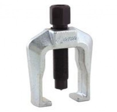

If you can get a tie-rod puller like the one below to work, you won't have to use a hammer.  Of course if you like pain, grab a pickle fork and a 3 pounder and have at it . . .
