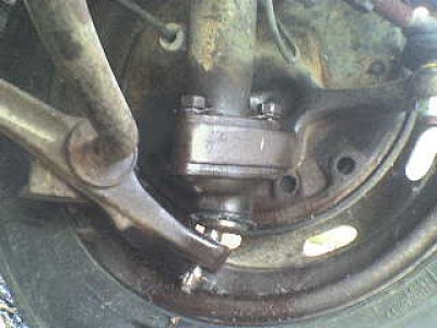

I went out today and was wacking a pickle fork trying to get the ball joint shaft to move.  .  I missed and wacked the back of my left hand.  Holy smolley  that hurts.   My hand is  swollen and my fingers are not working right.   Rats.  So I took a picture.   I'm saying What if  I take off the sway bar and that arm that the ball joint attaches to.   Them I take the the kit and kaoddle to a shop and they press out this thing.   If the tire is on the ground  how can the spring go KA Boing?   SC

O Boy !!   The coil spring will not go "KA-Boing" unless you take the CENTER nut off on top of the strut.   If you want to take the strut off the car , take off the 3 13mm nuts and what ever you are trying to do on the  bottom with the Track arms.  If you are going to replace the strut /shock, you will have to take the coil spring off.
     What did I tell you ?  Now you have already hurt yourselve and the games have just started.
     If your struts are "crap" as you say, Stupie will still shake rattle and roll and will take care of all your new parts you have put on already in short order
