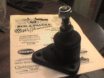

Well its my birth day this month so I  got a ball joint. 27 bucks at the shop in Dalton.  Whoopee.   I took all your advice.  then decided to do it myself.  From the looks of things  this might be easier since its a sooper beatnik.   I got the 3 upper bolts loose the bottom one is being stuborn and is about to be drilled out. I love working on Stupie when its drizzleing outside.  I need a garage.   I have one question.   Will the strut and coil spring burst through my chest  when I get the bolts removed?.    Sc
