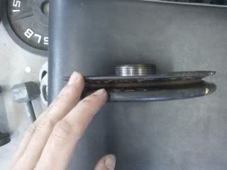

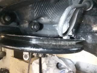

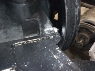

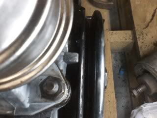

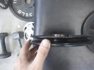

still working on this beast, and have encountered another issue. after pulling the crankshaft pulley to install the tin underneath it i went to replace to pulley and while tighting it up i notice it was starting to hit the engine tin, and was getting really close to the case. pictures below... i measured the pulley length where it goes toward the case, and it was about 5/8ths of an inch. im not sure if there are difrent lenths.
Re: almost movin'
« Reply #6 on: May 27, 2010, 09:02:27 AM »
Thats strange. Do you have another pulley to compare to ?  Did this pulley come with the long block ?

Re: almost movin'
« Reply #8 on: May 28, 2010, 06:02:22 AM »
This exact thing happened to me once before.  No idea why, but all i did was take the pulley back off, take the sheet metal to a grinder, put it all back together, no problems.  I don't know.   ???
Maybe the lips on the backsides of the pulleys are different????

Re: almost movin'
« Reply #9 on: June 09, 2010, 11:19:29 PM »

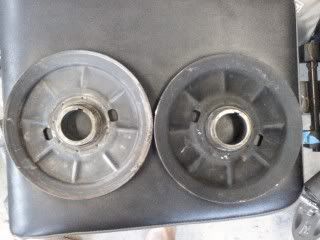

well i have finally got the chance to pick up my old pulley, and yes there is a difference.
 TDC's line up when compaired to the key slot. left is pulley that came with the new long block, right is pulley off my AE cases.
AE block pulley
new long block pulley
Re: almost movin'
« Reply #10 on: June 10, 2010, 08:00:07 AM »
This is very important .   On the three notch pulley, the notch on the left by its self is "O" . the other notches are 7 1/2 degrees advanced and 10 degrees advanced.
     I can't see the notch on the other pulley but if it has one rather big  mark on the outer edge (rim) ,that is "0" other than that they are interchangeable .

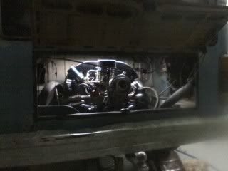

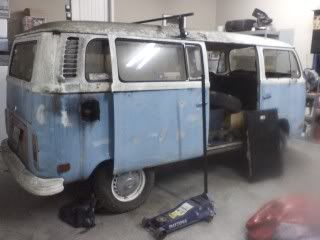

Finally was able to get my bus moved so i could get working on it.
  its was about 9pm as the Blue elephant rolled off the trailer and into the garage. Shes been neglected and extra dirty.

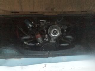

rear end in the air and engine mounted to traney
engine tin/type1 adapter fiberglass and seal installed. still have to deal with the holes in the rear engine tin that was for the heater boxes, on the look out for a decent pair, or engine tin without holes.
  got her outta the garage and gave her an over due bath, and to my surprise she was white and blue...

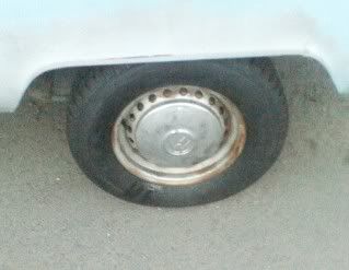

she also got some new shoes to replace the overly dryrotted Cooper Weather masters that were on the rear.
