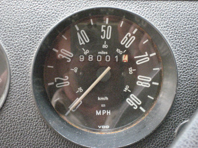

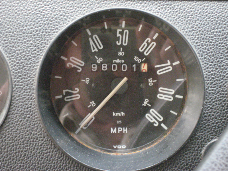

*DISCLAIMER*
This is in no way an endorsement of GEX rebuilt engines in general, or the one installed at ~93K in me Rivi.
However, these are the facts as they stand...
Have I covered the point (er mileage) spread yet?
Merry VWing, Mike
