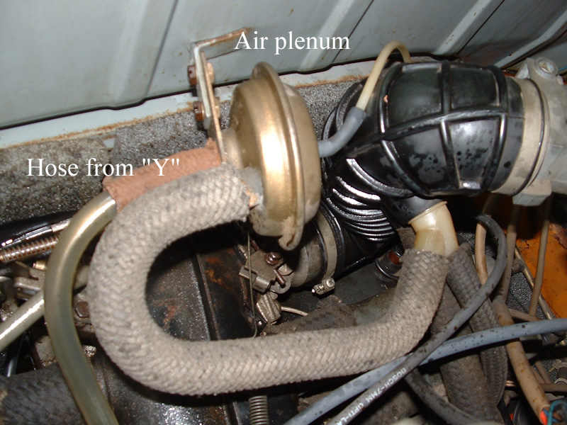

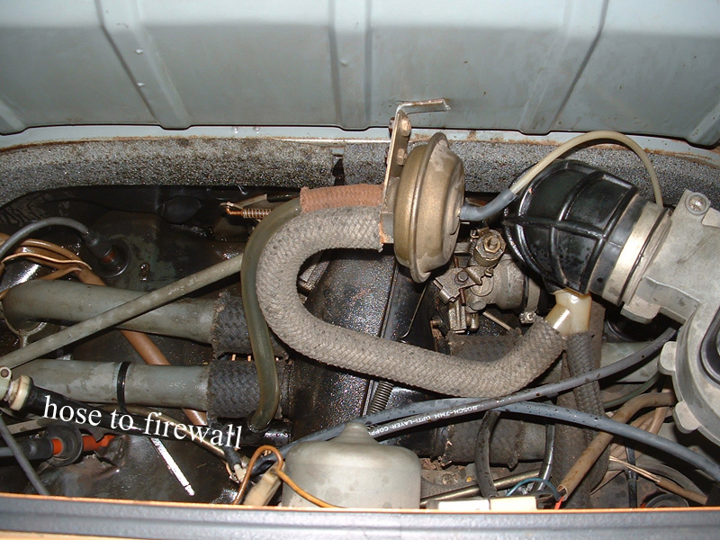

Well, that nailed it. I poked around and found a couple of hoses that were loose. One went to a canister on the right rear wall, which I think is of minor importance.
The other one was a line that runs into the firewall on the left side and entered the engine at the manifold...or at least I think it's the manifold. Maybe the airplenum. Not being all that savvy on my engine, I'm not sure how to identify it.
In any event, started right up. Thanks!

« Reply #3 on: June 24, 2006, 12:55:02 AM »
Good  deal !   That hose could have been the hose to the brake booster. Did you have any problem with the brakes ?  Anyway ,you are very welcome and glad it was that simple :thumbs-up:

That is most likely the evaporative canister to "filter" the gas fumes from the gas tank.  It is filled with charcoal (or a charcoal like substance).

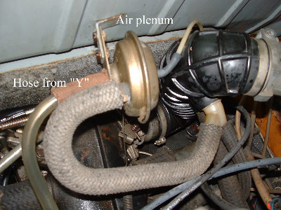

Like RetBugtech said, that is most likely the hose to the brake booster.  It should connect to a "Y" fitting...one part of the "Y" goes up to air plenum with an extended hard plastic hose, and the other part continues on to the air manifold.  If you had been driving with it unattached, your brakes would still work, but you would have to work harder to stop the bus.

« Reply #5 on: June 24, 2006, 12:03:56 PM »
That's it. The hose from the firewall was loose at the Y junction. Why would that particular hose make the engine race or die off if it's connected to the brake booster? I didn't notice any brake problems while driving.

« Reply #6 on: June 24, 2006, 01:56:36 PM »
If it is not connected, then there is a vacuum leak.  These fuel injected critters will not run right if there is the slightest vacuum leak.
